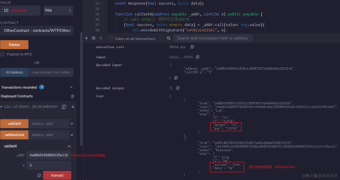

2. Calling the setX Function
We will define a callSetX function to call the target contract's setX() function, send msg.value amount of ETH, and emit the Response event to output success and data:
function callSetX(address payable _addr, uint256 x) public payable {
    // Call setX(), and send ETH at the same time
    (bool success, bytes memory data) = _addr.call{value: msg.value}(
        abi.encodeWithSignature("setX(uint256)", x)
emit Response(success, data); // Emit event
Next, we will call callSetX to set the state variable _x to 5, using the OtherContract address and 5 as parameters. Since the target function setX() has no return value, the data output by the Response event will be 0x, which is empty.

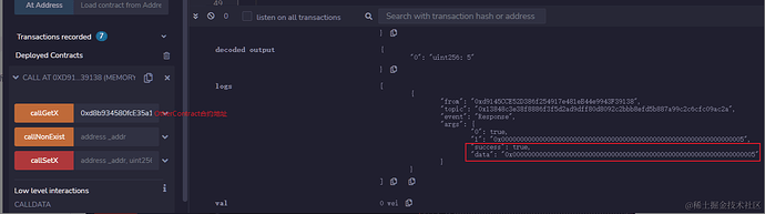

3. Calling the getX Function
Below we will call the getX() function, which will return the value of the target contract's _x variable, with type uint256. We can use abi.decode to decode the data return value from call and retrieve the numeric value.
function callGetX(address _addr) external returns(uint256){
    // Call getX()
    (bool success, bytes memory data) = _addr.call(
        abi.encodeWithSignature("getX()")
return abi.decode(data, (uint256));
From the output of the Response event, we can see that data is 0x0000000000000000000000000000000000000000000000000000000000000005. After decoding with abi.decode, the final return value is 5.

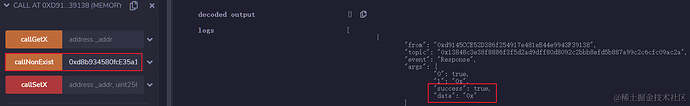

4. Calling a Non-Existent Function
If the function you pass to call does not exist in the target contract, the target contract's fallback function will be triggered.
function callNonExist(address _addr) external{
    // Call getX()
        abi.encodeWithSignature("foo(uint256)")
In the example above, we used call to call the non-existent foo function. call will still execute successfully and return success, but it will actually call the target contract's fallback function.
