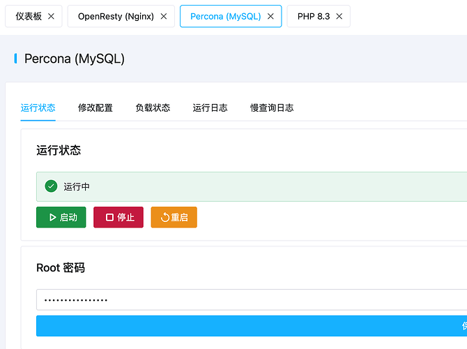

Log in to the old panel, check applications such as OpenResty, Percona, PHP in sequence, ensure they are running normally, and record the current version/configuration (for verification after migration).

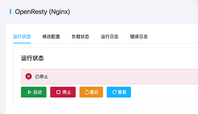

2) Stop websites and environment operations

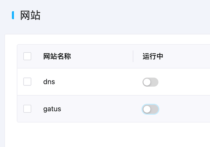

  • Go to Websites and stop all running websites.

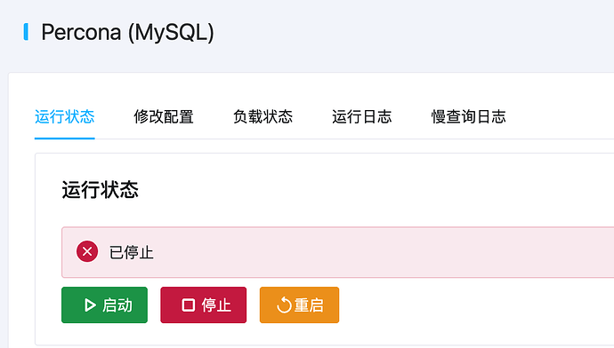

  • Go to Applications and stop all running applications (OpenResty / Database / PHP / other services) until all are stopped.

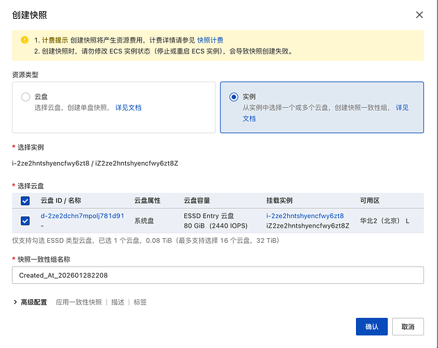

3) Take a server snapshot/backup
Go to the server console, perform the snapshot/backup operation on the server to be upgraded, and be sure to wait for the backup to complete before proceeding with the subsequent steps.

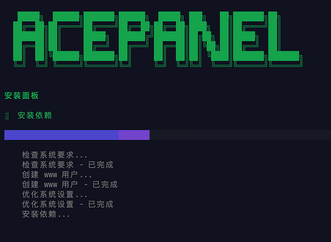

Install the New Panel
After completing the “partial uninstallation” of the old panel applications, start installing the new panel.
Run the following command and follow the prompts to complete the installation:
bash <(curl -sSLm 10 https://dl.acepanel.net/helper.sh)

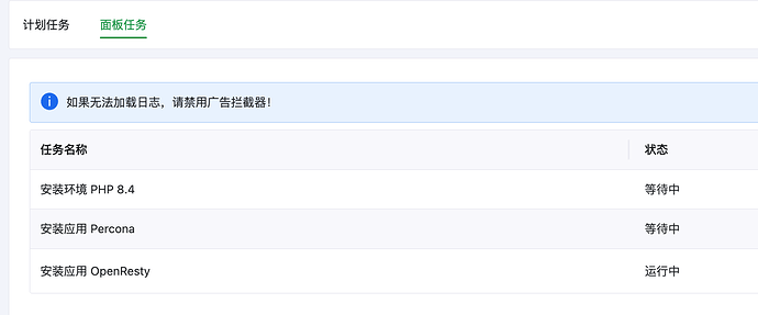

After the installation is complete, log in to the new panel and install the same environment as the old panel (such as OpenResty, Percona, PostgreSQL, PHP versions and related components).
Wait for the environment installation to complete before proceeding to the next step.

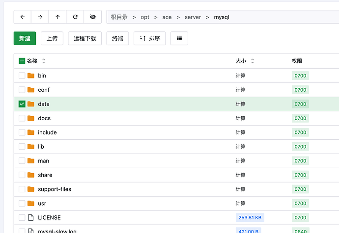

Percona (MySQL)
  1. Stop the new panel’s Percona.

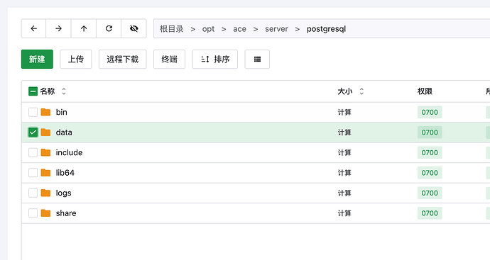

  2. In the new panel’s Files, go to: /opt/ace/server/mysql and delete the data directory.
  3. Go to the old panel’s Percona directory (example: /www/server/mysql) and migrate the data directory to the new panel: /opt/ace/server/mysql/.

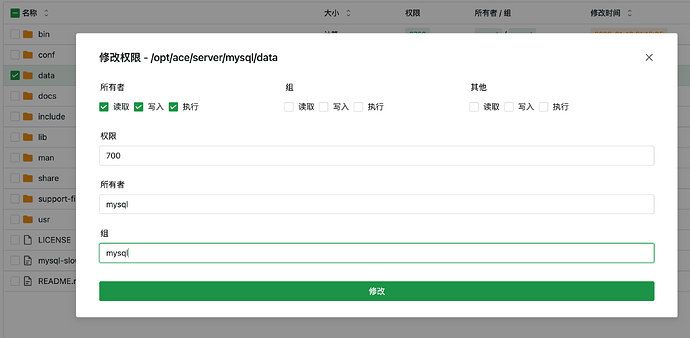

  4. Set the directory permissions to 700 and the owner to mysql.

  2. In the new panel’s Files, go to: /opt/ace/server/postgresql and delete the data directory.
  3. Go to the old panel’s PostgreSQL directory (example: /www/server/postgresql) and migrate the data directory to the new panel: /opt/ace/server/postgresql/.
  4. Set the directory permissions to 700 and the owner to postgres.

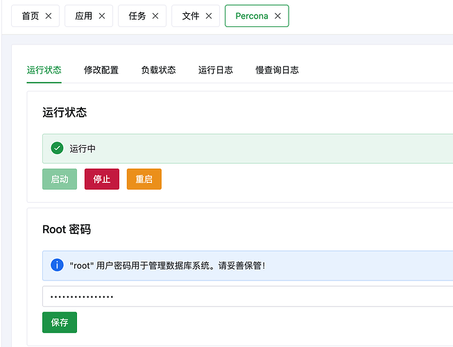

After completing the above migration, return to the new panel, start each application in sequence and confirm that they are running normally; if some applications fail to start, first check the corresponding error logs and fix them.
Note: After starting Percona / PostgreSQL, you need to change the password once in the panel, otherwise the panel’s database management function may not work properly.
