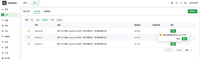

First, install the Node.js 24 runtime environment via the panel.

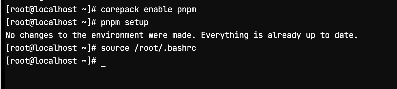

After installation, enable pnpm in the panel’s terminal (do not use the panel’s built-in local host; you should either create a new 127.0.0.1 host yourself or use an SSH client, as the panel’s built-in local host does not support full interactivity).
I personally prefer using pnpm, but you can use the default npm if you want.
corepack enable pnpm
pnpm setup
source /root/.bashrc

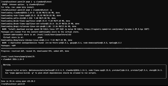

Once pnpm is installed, you can install clawdbot.
pnpm i clawdbot@latest -g

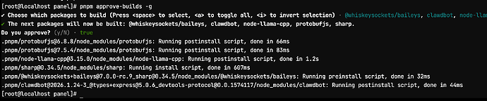

You also need to approve build script execution.
pnpm approve-builds -g
Press the a key to select all, then press Enter and type y to confirm.

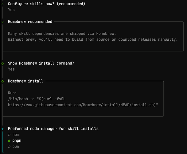

Once this is done, you can initialize clawdbot.

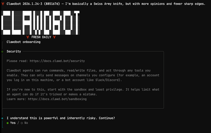

clawdbot onboard
Agree to the risks, select quick initialization, and I skipped all the settings here just to get it running first.

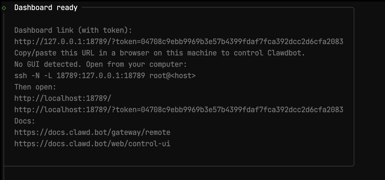

You’ll know it’s finished when you see the image below. Copy and save the login URL with the token, as you’ll need it later.

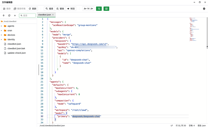

Don’t rush to start it after installation; modify the configuration file to add the third-party APIs you need.
Configuration file path: /root/.clawdbot/clawdbot.json
Template: OpenAI-compatible Relay
  "models": {
    "mode": "merge",
    "providers": {
      "gemini": {
        "baseUrl": "https://your-relay-api/v1",
        "apiKey": "test",
        "api": "openai-completions",
        "models": [
            "id": "gemini-3-flash",
            "name": "gemini-3-flash"
Attached is my configuration reference, which uses the official DeepSeek API. The only thing to note is that when agents reference a model, you need to add the provider prefix, otherwise it will be resolved to the model from Company A.

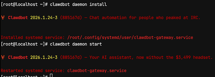

Then install and start the service.
clawdbot daemon install
clawdbot daemon start

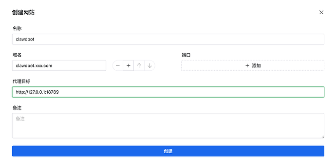

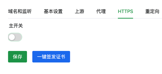

Go to Panel Apps → Native Apps → Install Nginx/OpenResty, then create a new reverse proxy website and assign your domain name to it.
Edit the website, go to the HTTPS tab to issue a certificate with one click, then enable HTTPS and HTTP redirection.

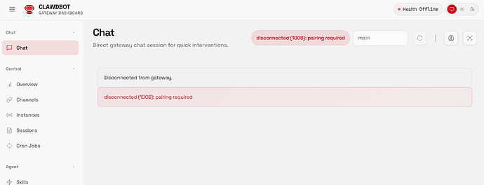

Append ?token=the token you saved earlier to your domain name, open the backend, and you will be prompted to pair the device.

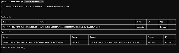

Return to the terminal and run clawdbot devices list to view the pending pairing devices.
Run clawdbot devices approve request-id to approve the pairing.
clawdbot devices approve 98b5fee7-415e-48f3-9e8e-c59886150af9

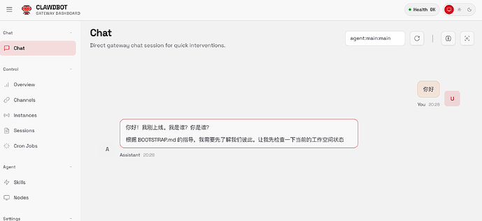

Then return to the console; when the status changes to OK, you can start using it.
