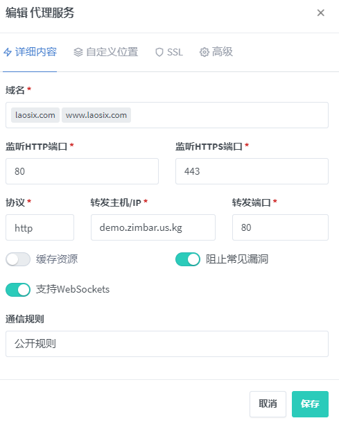

This is the proxy configuration; the target server is a website that is accessible. demo.zimbar.us.kg
Is this correct or incorrect? I currently cannot access demo.zimbar.us.kg using my domain name.

But my target address is not local, but another site: demo.zimbar.us.kg
This is the correct one.
