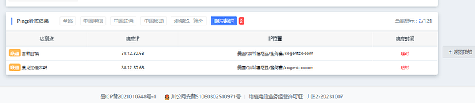

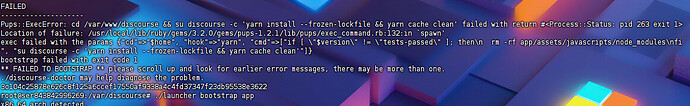

Is your server hosted in China? As shown in the image, yarn installation failed.
American
Additionally, the IP is not blocked for overseas access. If you have time, could I privately send you the SSH link for you to check it out?
I do not provide remote support, and another possible cause of the issue is that your memory is too small.
4G RAM, 4 cores, this should meet the running requirements, right?

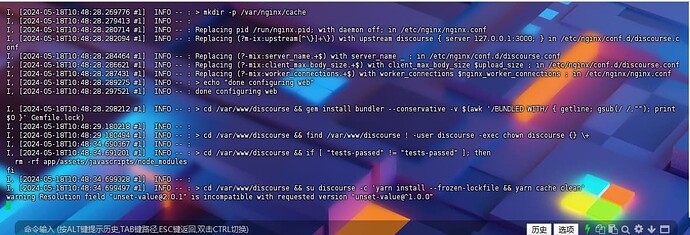

Could you recrop this image further back to see more?
Try a different system.
I recommend you use mine

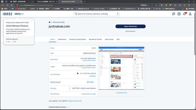

At the time, I entered a wildcard domain www.
mark
I can’t believe this, my domain still hasn’t passed review even though I’ve already finished setting up the domain resolution correctly.

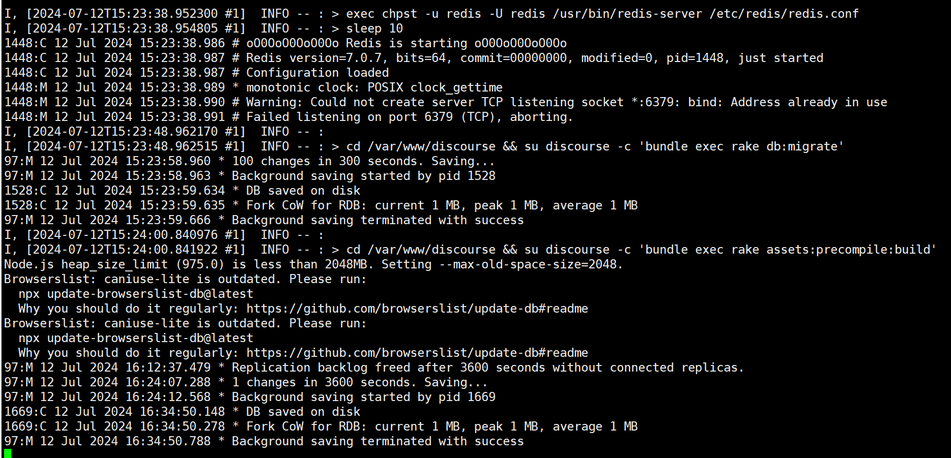

My server has very low specs, it froze during the update process and I cannot complete the update. Is there any way to roll back to the previous version?
This is what the output looks like. How long is this update going to take? It has already been more than ten hours. Is there any way to roll back to the previous version? Thank you.
You can end it with Ctrl+C, then add some swap and re-run ./launcher rebuild app
