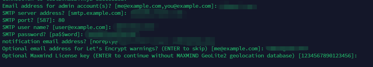

Next, you will be asked to enter your administrator email address, SMTP server, SMTP port, SMTP username, SMTP password, notification email address, as well as the optional Let’s Encrypt notification email address and Maxmind license key. Fill out all required fields as prompted.

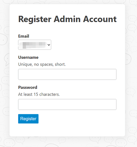

Open your forum’s domain name in a web browser to configure your website settings and create your administrator account.
Activate your administrator account via email and log in to the admin dashboard. The installation is now complete! Congratulations on setting up your own Discourse forum.

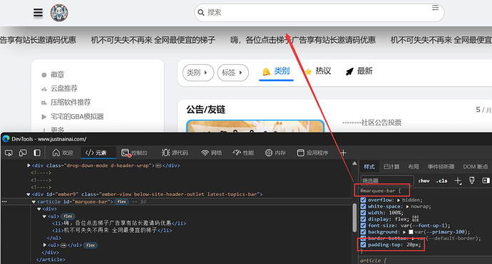

Looks good. How was the multi-language switch on the header implemented? Is it a plugin?
The frosted glass effect of the top navigation looks good, but the text below is too close to the top navigation bar.
You can use the padding-top code to add some spacing.

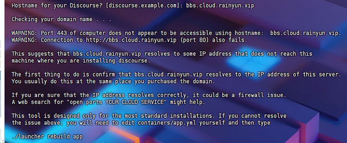

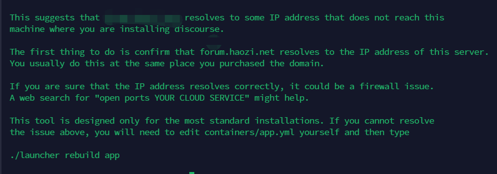

Could you please explain this to me? This keeps happening to me.
Also, I really haven’t been able to find any other tutorials that cover this.
It is recommended that you properly complete the parsing first. If you are sure you want to skip parsing, refer to this article.

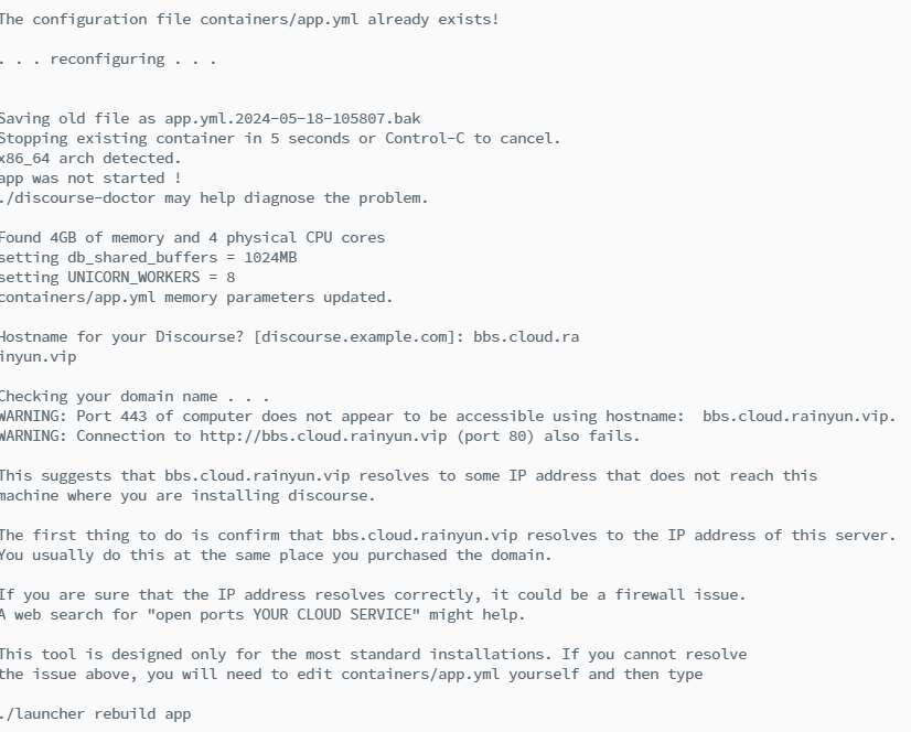

It still doesn’t work. This time I chose to directly delete the data and did not install the panel, but it is still the same issue:
Did you run ./discourse-setup --skip-connection-test?
Okay, the domain can now be bound normally, but another error occurred:
ENTER to continue, ‘n’ to try again, Ctrl+C to exit:
letsencrypt.ssl.template.yml enabled
Configuration file at containers/app.yml updated successfully!
DISCOURSE_DEVELOPER_EMAILS left at incorrect default of me@example.com,you@example.com
Sorry, these containers/app.yml settings aren’t valid – can’t continue!
If you have unusual requirements, edit containers/app.yml and then:
./launcher bootstrap app
Which translates to: Sorry, these containers/app.yml settings are invalid - cannot continue!
If you have unusual requirements, edit containers/app.yml, then:
