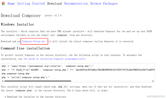

1. Create a Laravel Project
Before creating your first Laravel project, ensure that PHP and Composer are installed on your local machine.
1.1 Environment

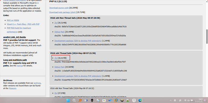

PHP 8.2
Laravel 11.x requires a minimum PHP version of 8.2.
Composer

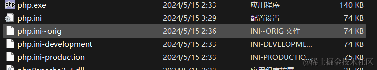

If you do not have a `php.ini` file, rename either php.ini-production or php.ini-development to php.ini

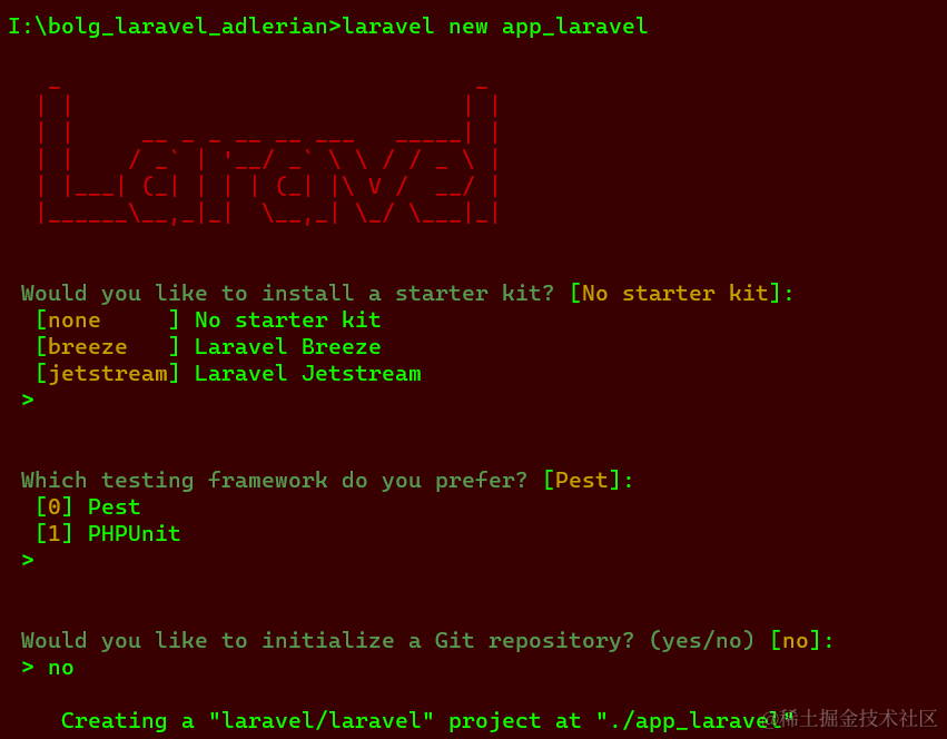

Alternatively, you can globally install the Laravel Installer via Composer to create new Laravel projects:
composer global require laravel/installer
laravel new example-app

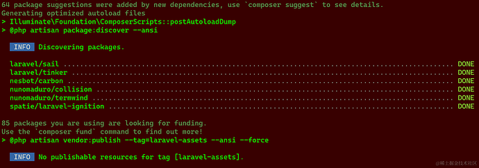

1.3 Install Dependencies
After creating the project, navigate to the project folder and install dependencies
cd example-app
composer install

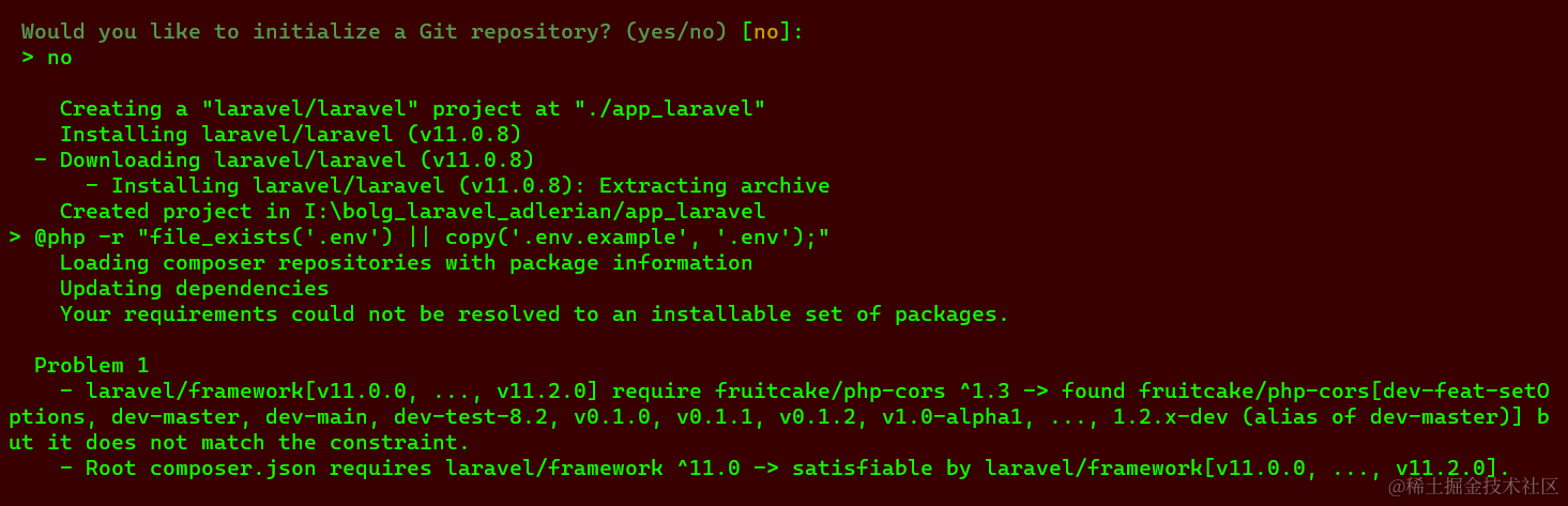

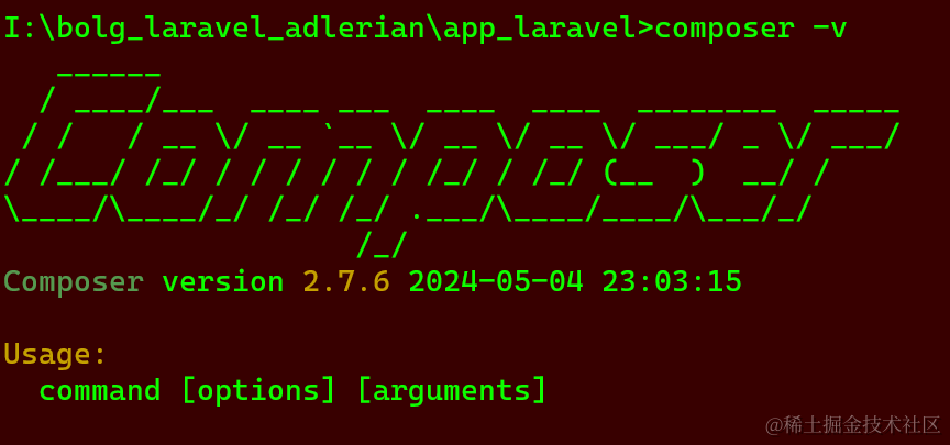

If you encounter the error Your requirements could not be resolved to an installable set of packages., this issue is caused by incorrect version configuration. First, check that your version number is formatted correctly.
Check your Composer version
composer -v
If you are not running the latest version, run the command to update Composer
composer self-update

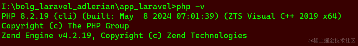

Check your PHP version
php -v

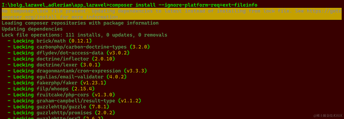

If your versions are correct, run the install command ignoring platform requirements
composer install --ignore-platform-req=ext-fileinfo
Or
composer update --ignore-platform-req=ext-fileinfo

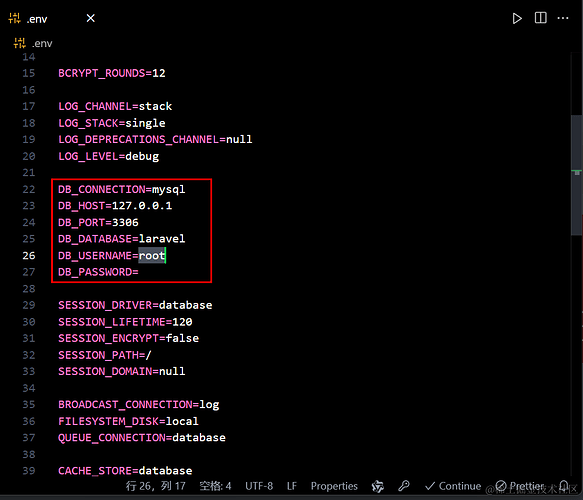

If you do not want to use SQLite, modify the .env file as follows:
# Modify timezone and locale
APP_TIMEZONE=PRC
APP_LOCALE=zh-CN
Modify MySQL configuration
DB_CONNECTION=mysql
DB_HOST=127.0.0.1
DB_PORT=3306
DB_DATABASE=laravel
DB_USERNAME=root
DB_PASSWORD=123456
Please create the relevant database first.

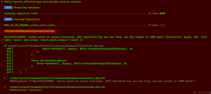

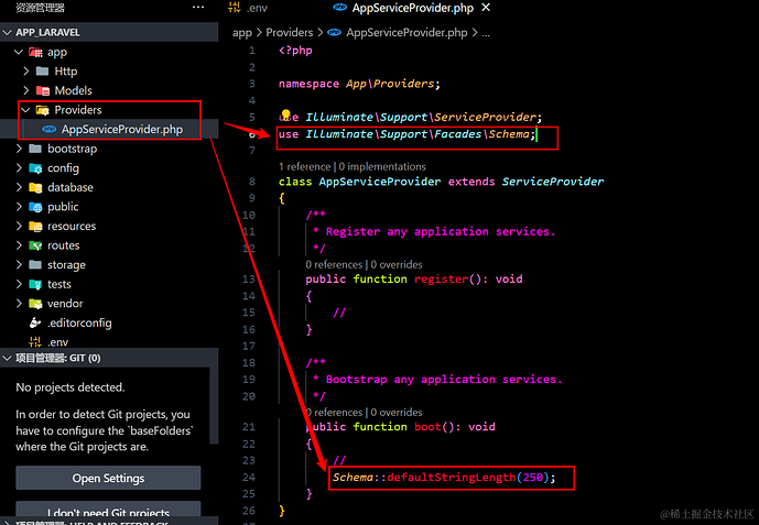

If you encounter an error, first delete the already created users table from your database
Then add the following code to app/Providers/AppServiceProvider.php
use Illuminate\Support\Facades\Schema;
Schema::defaultStringLength(250);
Run the database migrations
php artisan migrate

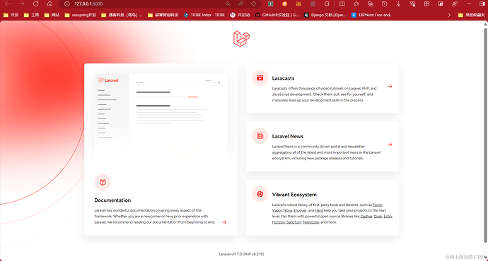

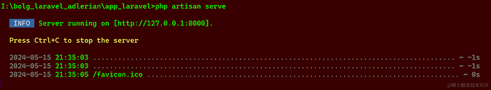

1.4 Start the Server
Use Laravel Artisan's serve command to start Laravel's local development server:
php artisan serve
After the server starts, you can access your project via http://127.0.0.1:8000.

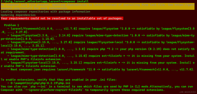

Issue 2: Encountered the error "Your requirements could not be resolved to an installable set of packages."
Solution
This error is caused by incorrect version configuration. First, use composer -v and php -v to check that your versions are correct.
Run this command to resolve:

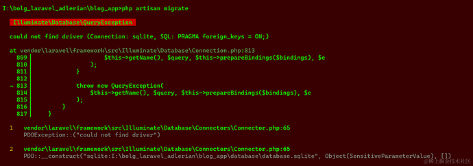

Issue 4: Returned error message: "could not driver"
Solution:
1. Check if required extensions are enabled. Open `php.ini` and confirm the following two extensions are uncommented
extension=php_pdo_pgsql.dll
extension=php_pgsql.dll
2. Check that your connection information is correct
DB_CONNECTION=mysql
DB_HOST=127.0.0.1
# Database port
DB_PORT=5432
# Database name
DB_DATABASE=
# Database username
DB_USERNAME=
# Database password
DB_PASSWORD=

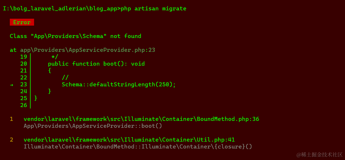

Issue 5: Error message "Error"
class "App\Providers\Schema" not found
Solution:
The relevant dependency is not imported in app/Providers/AppServiceProvider.php. Adding the import will resolve the issue

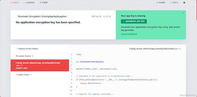

Issue 6: NO application encryption Key has been specifled.
Solution:
Run the command to generate the encryption key
php artisan key:generate

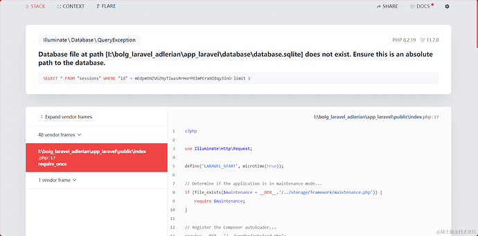

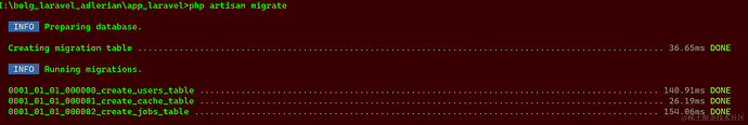

Issue 7: Database file at path [l:.bolg_laravel_adlerian\app_laravel\database\database.sqlite] does not exist. Ensure this is an absolute path to the database.
SQLite does not have an existing database, run the migration command to create it
