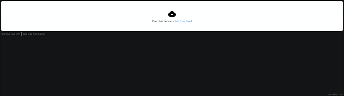

The last time I implemented a file upload feature, I used a native HTML form. For this example, we are working in a Vue project, and we will use the el-upload component from Element Plus to complete the frontend development for file upload.
The implementation code is as follows:
Drop file here or click to upload
jpg/png files with a size less than 500kb

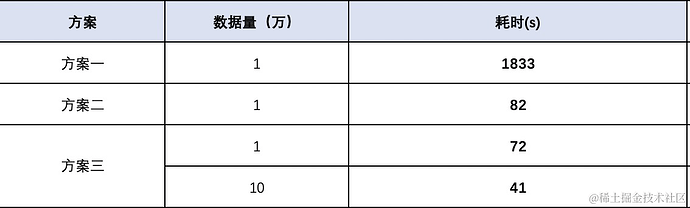

Based on my limited development experience, I have listed three solutions. Solution 1 uses 10,000 test records (to save time), and Solution 3 uses 100,000 test records.
Solution 1
Solution 1 is the conventional process: insert a row into the database every time a line of data is read.
@Insert("insert into test values(#{a}, #{b}, #{c}, #{d})")
void insertFile(Test test);
Total time taken to insert into database: 1833s

We defined a count counter, and use modulo to insert 100 records per batch. Final result: Total time taken to insert into database: 82s

Test result with 3 threads: Total time taken to insert into database: 72s. After changing to 6 threads, test result: Total time taken to insert into database: 60s
Then I inserted 100,000 records, total time taken for database insertion: 41s. Maybe my mobile hotspot was less laggy this time, or maybe the performance scaled better with the larger workload.

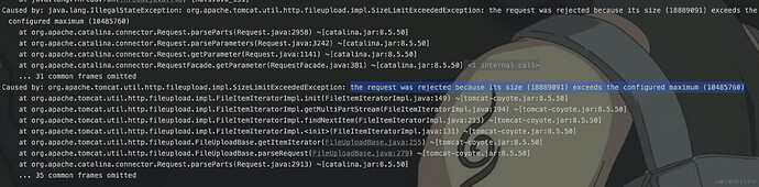

I don't often implement file upload with Spring Boot, so when I tested the upload, I got the following exception: "the request was rejected because its size (18889091) exceeds the configured maximum (10485760)".

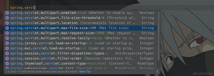

The exception indicates that the file upload request was rejected because it exceeded the size limit. You can fix this by modifying the default limit in application.properties.
spring.servlet.multipart.max-file-size is used to set the maximum file size limit for a single file upload, and spring.servlet.multipart.max-request-size is used to set the maximum size limit for the entire request (including all files and form data).
