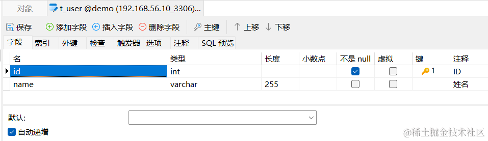

User table:

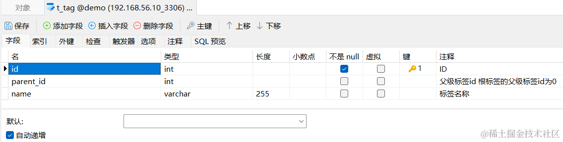

Tag table:

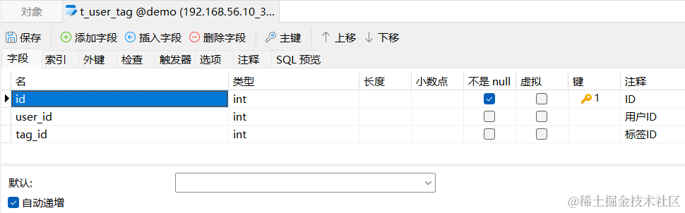

User-tag relationship table:
The table design above is easy to understand:
  1. The tag table has a parentId field, which is used to record the parent tag ID of the current tag. The parent tag ID of the root tag defaults to 0.
  2. The many-to-many relationship between users and tags is maintained by the intermediate table t_user_tag.
