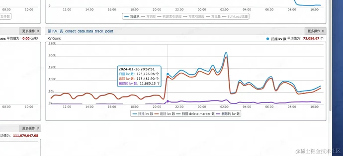

After the Lindorm team got involved, they identified the slow SQL and asked our business team to conduct a self-check. But we had not released any new versions recently, so we really could not find the source of the problem at first. The Lindorm team found through the monitoring platform that the read volume of the `data_track_point` table had increased sharply, and asked us to check if there had been any changes to the query method or any major changes to input parameters.

Finally, when checking recent events, we found that there was a full OTA upgrade for all devices overnight. We then suspected that this might be the cause, and the upgrade time point perfectly matched the sharp increase in read volume to Lindorm. We carefully checked the input parameters of the rate-limited interface, and found that some requests passed 0 as the start time. This interface uses the start time to perform a range query on `data_track_point`, so we had basically located the problem at this point.
We asked the client-side team why 0 was passed as the start time, and they told us that the device's system time is reset to 0 after an OTA. But we had done many OTA upgrades before, so why was there a problem only this time? The main reason is that previously this data was stored in MySQL for only 1 month; after switching to Lindorm, we store 3 months of data (and we used the cold storage feature). Query performance is not Lindorm's strength compared to MySQL, and querying such a large range of data is a nightmare for any database.
