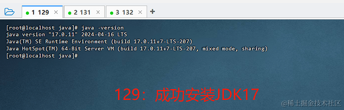

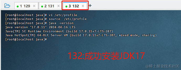

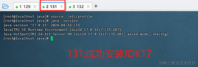

1.2 Install JDK 17
centos7: Detailed steps to install JDK

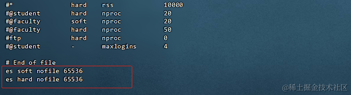

ES requires the maximum number of open files per process to be at least 65536. Run the following on every machine:
vi /etc/security/limits.conf
* soft nofile 65536
* hard nofile 65536

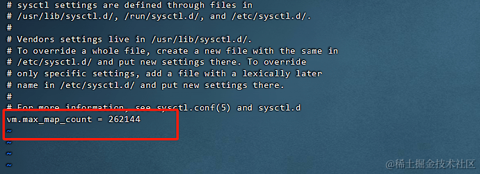

Modify the /etc/sysctl.conf file
vi /etc/sysctl.conf
vm.max_map_count = 262144
Reload configuration
sysctl -p

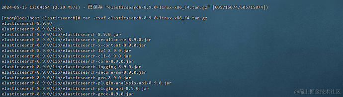

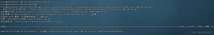

1.3 Download elasticsearch-8.9.0
Download the installation package
wget https://artifacts.elastic.co/downloads/elasticsearch/elasticsearch-8.9.0-linux-x86_64.tar.gz
Extract the package
tar -zxvf elasticsearch-8.9.0-linux-x86_64.tar.gz

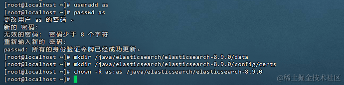

1.4 Create the `as` user (ES does not allow running as the root user by default)
useradd as
passwd as
① Create a new data directory
mkdir /java/elasticsearch/elasticsearch-8.9.0/data
② Create a new certificate directory
mkdir /java/elasticsearch/elasticsearch-8.9.0/config/certs
③ Change the file owner
chown -R as:as /java/elasticsearch/elasticsearch-8.9.0
④ Switch to the ES user
su as
cd /java/elasticsearch/elasticsearch-8.9.0/bin/

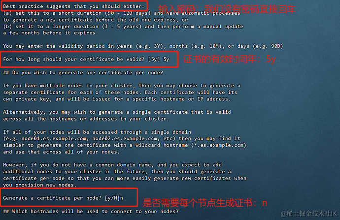

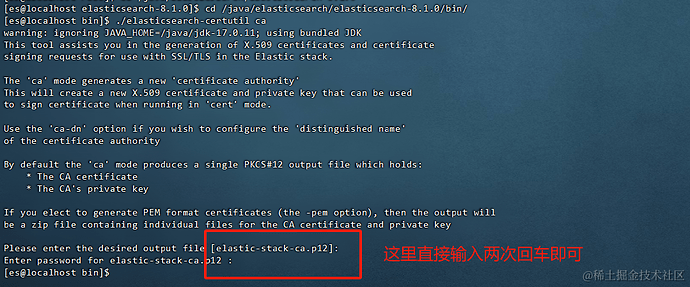

⑤ Issue the CA certificate
./elasticsearch-certutil ca

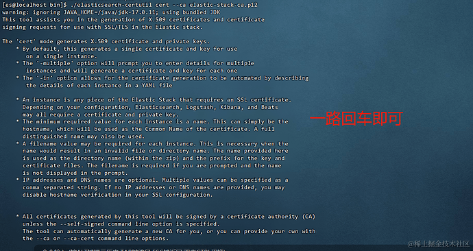

⑥ Issue node certificates using the CA certificate
./elasticsearch-certutil cert --ca elastic-stack-ca.p12
⑦ Move the generated certificates to the certificate directory
mv /java/elasticsearch/elasticsearch-8.9.0/elastic-stack-ca.p12 /java/elasticsearch/elasticsearch-8.9.0/config/certs/

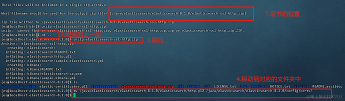

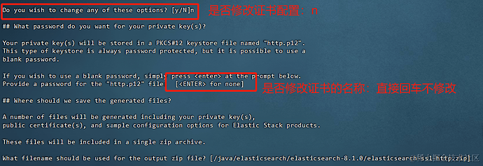

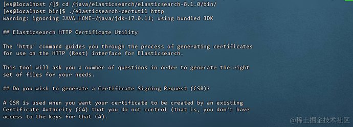

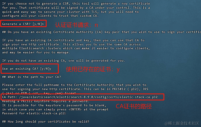

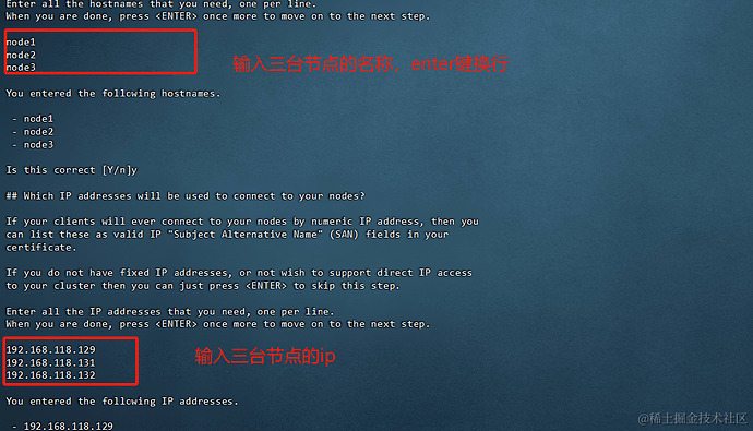

1.5 Issue HTTP certificates on centos:129
./elasticsearch-certutil http
Check the certificate location, unzip and move it to the certificate directory
cd ..
unzip elasticsearch-ssl-http.zip
mv /java/elasticsearch/elasticsearch-8.9.0/elasticsearch/http.p12 /java/elasticsearch/elasticsearch-8.9.0/config/certs/

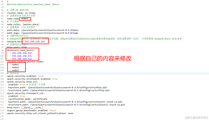

Modify the config/elasticsearch.yml file: add the following configuration at the end of the file
# Set ES cluster name
cluster.name: es-study
# Set current node name in the cluster
node.name: node1
# Node roles
node.roles: [master,data]
# Set paths for data and log files
path.data: /java/elasticsearch/elasticsearch-8.9.0/data
path.logs: /java/elasticsearch/elasticsearch-8.9.0/logs
# Configure network access
# You must configure the network and port. If security is a concern, set host to the IP address that will access this Elasticsearch server to restrict access. You can also set network.host: 0.0.0.0 to allow access from any address.
network.host: 192.168.118.129
# Set network access port
http.port: 9200
discovery.seed_hosts:
  - 192.168.118.129
  - 192.168.118.131
  - 192.168.118.132
cluster.initial_master_nodes:
  - node1
  - node2
  - node3
# Security authentication
xpack.security.enabled: true
xpack.security.enrollment.enabled: true
xpack.security.http.ssl:
 enabled: true # Note the leading space
 keystore.path: /java/elasticsearch/elasticsearch-8.9.0/config/certs/http.p12
 truststore.path: /java/elasticsearch/elasticsearch-8.9.0/config/certs/http.p12
xpack.security.transport.ssl:
 enabled: true
 verification_mode: certificate
 keystore.path: /java/elasticsearch/elasticsearch-8.9.0/config/certs/elastic-stack-ca.p12
 truststore.path: /java/elasticsearch/elasticsearch-8.9.0/config/certs/elastic-stack-ca.p12
http.host: [_local_, _site_]
ingest.geoip.downloader.enabled: false
xpack.security.http.ssl.client_authentication: none

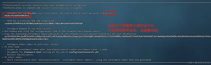

1.6 Start ES on centos:129
cd bin/
./elasticsearch

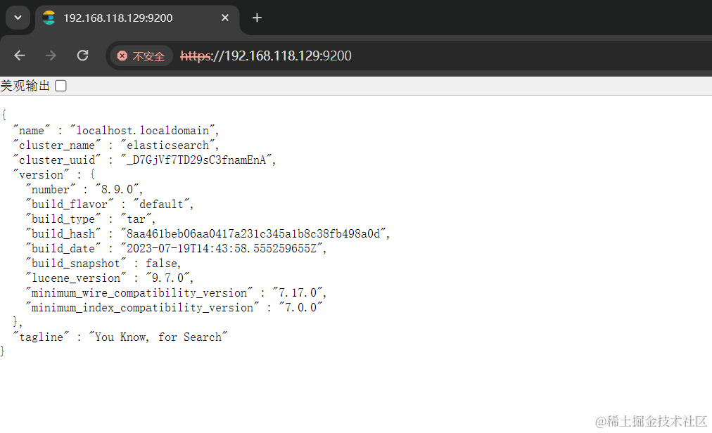

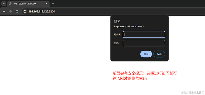

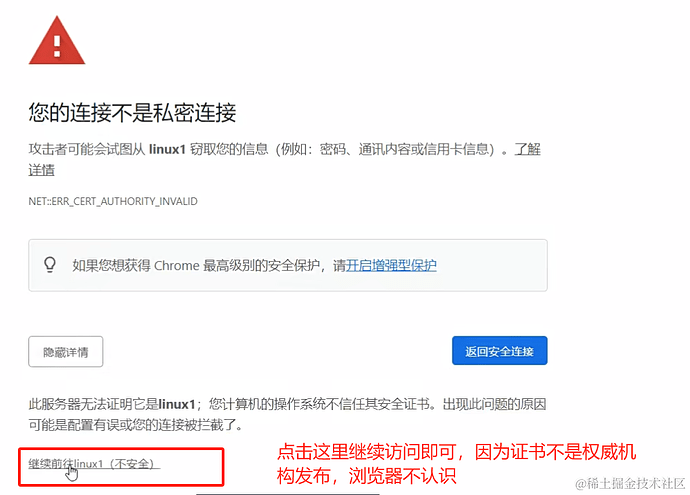

1.7 Enter the following address in your browser:
https://192.168.118.129:9200/
1.7 Start ES on centos:131
You need to create the user, modify memory configuration, create the data and certs directories, just repeat the same steps done above.

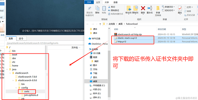

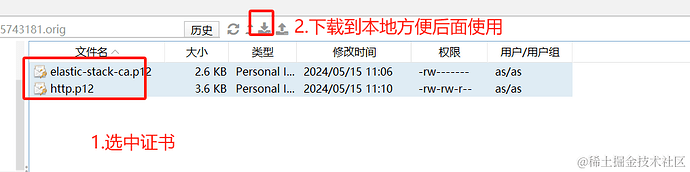

Download the certificates from centos:129, then upload them to the corresponding directory on centos:131

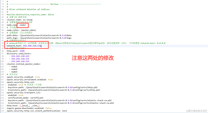

Modify the elasticsearch.yml configuration
node.name: node2
# Node roles
network.host: 192.168.118.131
http.port: 9200
  - 192.168.118.129
  - 192.168.118.131
  - 192.168.118.132
  - node1
  - node2
  - node3
 enabled: true
